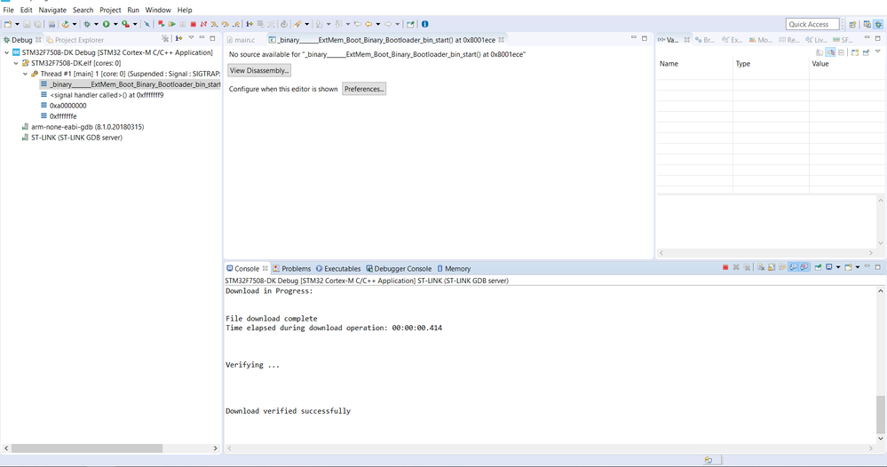

I had success in creating and debugging a blinky project when created from cube IDE, but not using touchgfx generated project for this board
I am not able to start a debugging session for project created by touchgfx.
Things I have tried:
1.Explicitly changing to "External loader" from "Debug configuration" corresponding to this board
To recreate this issue:
As "Resume" is clicked in debug perspective, after a few seconds the following state is encountered (image) and board stays in blank state forever (LCD white)
Environment:
Windows 10 x64
CubeIDE 1.4.0
CubeMX6.0.1
TouchGFX 4.14.0
MCU PACKAGE FW_F7_V1.15.0
Please help on this issue
Thanks,
Eshwar

I have concluded that the issue comes form the IDE. Please download and see the attached short videos. I have created them to clearly convey the issue to you.
Video description
video 1 Run target for touchGFX, flashing succeeded, Auto reset [OK]
video 2 flash from cubeProgrammer, flashing succeeded, Auto reset [OK]
video 3 Flash for "Debug as STM32 . . ." option, flash succeeded, No auto reset but needed manual USB disconnect and reconnect. In addition to this, there was debug launch error [NEED SOLUTION]
This is the main issue I am facing.

When I created project from cubeIDE, debug works. This is because the STM32F750N8HX_FLASH.ld has FLASH and RAM memory definitions exactly as per actual hardware i.e 320kb RAM and 64kb ROM. I am not using this method for integrating with touchgfx because I face FLASH overflow error even if a single screen is created. I this case debug is launching fine until touchGFX is not integrated. After touchGFX integration, flash overflow occurs and build fails. I tried to edit STM32F750N8HX_FLASH.ld to make use of QSPI for touchgfx related assets but failed. So I discarded this way of development. If this could be resolved by your support, I am ok with that. Now lets look at case 2
Case2:
So I created from touchgfx designer, the readymade template to work further. This case did not cause any flash overflow and build also succeeded. But debugging is really an issue. I saw a new folder created by touchgfx generator named "ExtMem_Boot" in project root dir ( ExtMem_Boot APPLICABLE ONLY FOR STM32F7508-DK ONLY)
On opening this folder, I found a readme.txt file. I strongly recommend you to read it. Summary: This is special Firmware developed by ST MCD Application Team to overcome the limitation of low flash capacity devices.
It is my guess that this is interfering with the normal debug launch. I am saying this because the error statement during debug fail "No source available for "_binary_______ExtMem_Boot_Binary_Bootloader_bin_start() at 0x8001ece" shows some relation with the folder "ExtMem_Boot"
Since I have just began working with STM32 platform, This is all I could conclude and provide to you
I request you to resolve any of the above case with this board or if possible, recreate at your end before resolving

You are right, indeed it is currently not possible to debug.
"This is special Firmware developed by ST MCD Application Team to overcome the limitation of low flash capacity devices" so we are not aware of what they did exactly for this part.
FYI, the F750-DK has such small Flash (we consider it Flash-less) that the code needs to be stored in external Flash, therefore outside the MCU.
We will try to investigate and see if we can come up with a workaround.
Sorry for the bother,
/Alexandre
