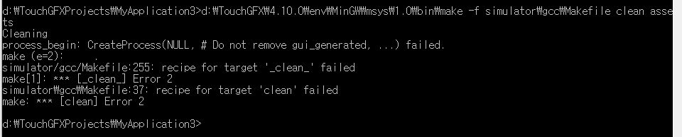

2019-09-25 6:01 AM
Thank you for your response..
You mean the following picture? Or please let me know what I have to do. Thanks in advance!
2019-09-25 6:08 AM
Okay, so CreateProcess fails. This is usually indicative of an additional msys.dll in your path. Do you have any others in your path? Some have fixed this by "rebasing" their msys.dll. You should be able to find some information about that either here or on your favorite search engine. Or you could remove the additional msys.dll along your path if you're not using it.
