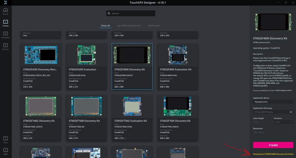

2022-01-24 11:25 PM
@Romain DIELEMAN
Hi
I'm having the same problem.
Tried your solutions but I was not successful.
Please find my screenshot attached as well.
Thanks,
Mas
2022-01-25 12:06 AM
Close TouchGFX Designer before opening a browser like Microsoft Edge and reopen it. This error message can also appear when your internet connection struggles downloading the packages due to its size/your internet connection speed. So you might need to try a few times unfortunately or download directly the TBS through this link for the STM32F469I Discovery kit:
/Romain
2022-01-25 12:50 AM
@Romain DIELEMAN
Thanks so much
it is fixed
Thanks for your prompt response
