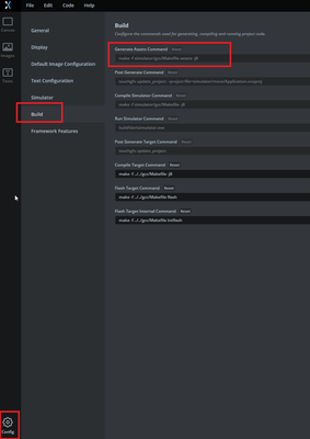

1) Can you go to "Config", "Build" and check what is in "Generate Assets Command" such as :

The generate assets command is the same as yours: make -f simulator/gcc/Makefile assets -j8. The board I am working on is a custom board and when I create a new project from the designer, this is in the box for Generate Assets Command: make -f simulator/gcc/Makefile assets -j8. Also, I do not see a framework folder inside my touchgfx folder which would contain the converters. What is the process of adding this?
