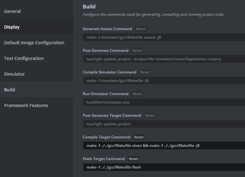

This is my configuration for the build:
Could someone please help solve this problem?

I've tried on my side to run a project based on the STM32H745I-disco board and it works fine both on the simulator and on target.
Your build configuration looks ok to me (doesn't seems that you changed from the default value did you?). Also, have you tried with an empty project?

Hi @Osman SOYKURT
I did not change anything in the build configuration. I do not dare to touch these, because I know something bad will happen.
