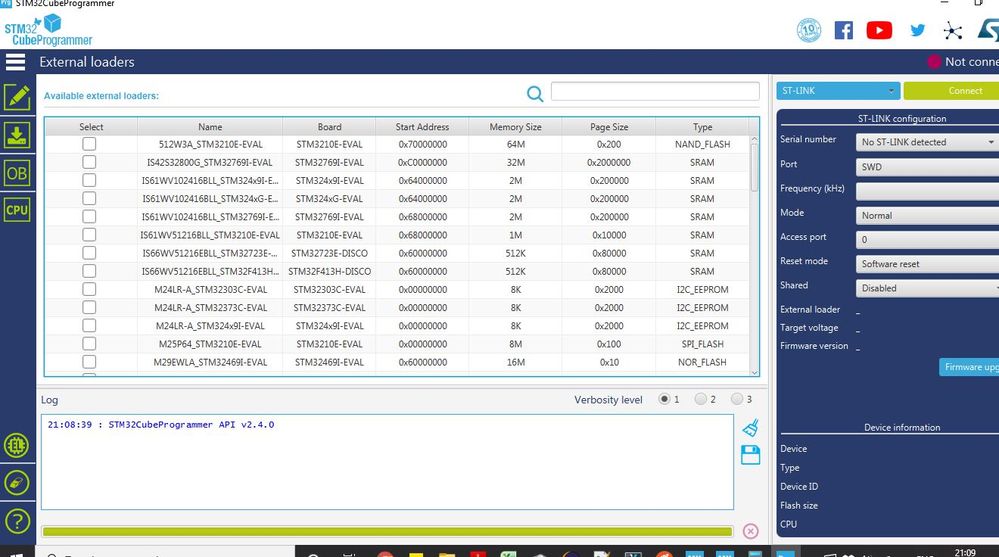

Also I can see external loader option in IDE STM32CUBE programmer. Not sure if this can help.

Sure, it would need an external loader which is compatible with your board (ie chip, clocks, wiring, etc)
