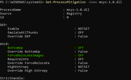

What is your windows version? Is it managed by your workplace so that ASLR cannot be disabled? Or does the powershell Set-ProcessMitigation command fail?

I'm running Windows 11. It is a workplace managed PC but I was able to disable the 'ForceRelocateImages' and 'BottomUp' mitigations. See the status image below.
Unfortunately even this combined with the rebase doesn't work for my PC.
