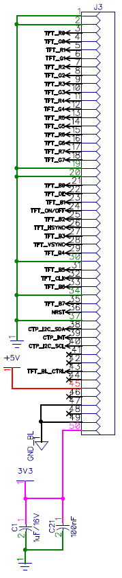

I am using STM32H7B33IIT6 MCU and 800x480 TFT. I can upload images to TFT, but I couldn't get the touch parts to work. But the same program works in STM32H7B3I-DK. What steps do I need to do?
2022-01-19 12:16 AM
Touchscreen is independent hardware. Usually it is an specialized external ADC on SPI or I2C bus. Check original schematics and your custom PCB. For example https://www.st.com/resource/en/schematic_pack/mb1332-h7b3i-b02_schematic.pdf shows that screen uses bus I2C4. Your should use the same bus and the same touchscreen IC - only then your firmware would work on both boards.
2022-01-19 1:37 AM
Thank you for answer but I use YB-TG800480S28A-C-A Yeebo screen externally, I made the pin connections accordingly. I connected I2C to I2C4 as in STM32H7B3I-DK. The screen is working. But the touch part is not working.
Do I need to write a special function for I2C? Can't I use I2C for STM32H7B3I-DK?
2022-01-19 2:06 AM
It looks like TG800480S29A uses ILI2117A touchscreen controller. You can check it on your screen. But original display board has RK043FN48H-CT672B display with FT5336GQQ controller (default address 01110000). You definitely need your own driver for your touchscreen controller.

Thank you for return. Shouldn't I change the I2C address and run it?
FT5336GQQ I2C Address > 0x70
ILI2117A I2C Address > 0x41
I made the change but it still doesn't work? Why is this happening? Could you help?

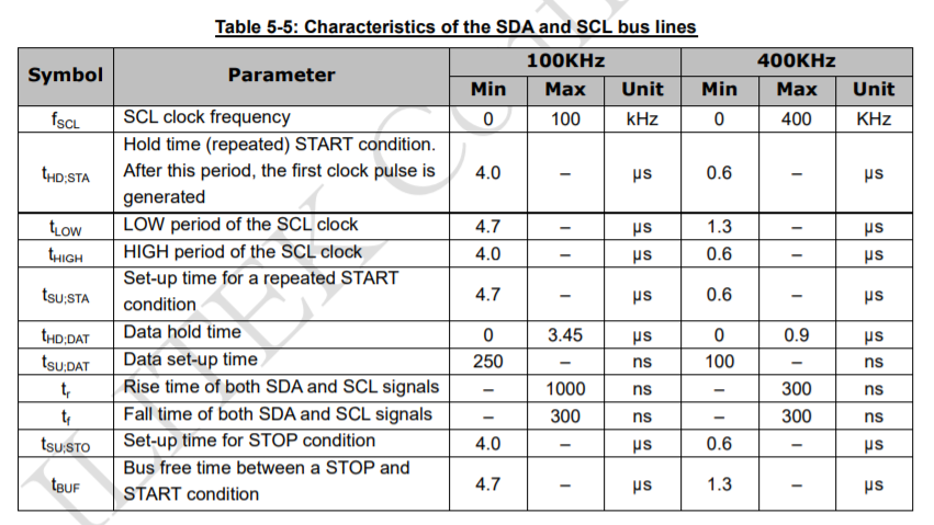

Thank you for comment but Both use the I2C protocol. I checked their datasheet. Are you talking about I2C Timing Characteristics?
2022-01-19 10:18 PM
No, I am talking about internal register structure and reading/writing sequence of those registers. You have to read datasheet for ILI2117A and implement algorithm described there. Timing usually is the same for many I2C devices. All should work at 100kHz, some can support 400kHz.
