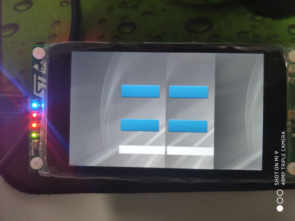

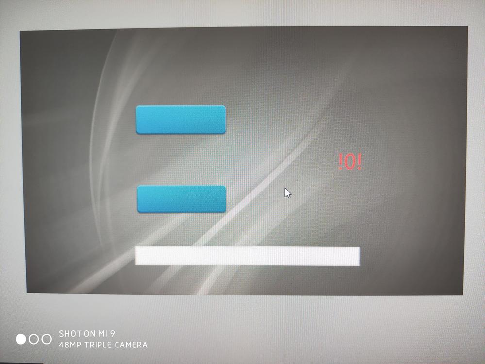

So for now there is no way we can use F469-DISCO on CubeMX combining with TouchGFX?
https://touchgfx.zendesk.com/hc/en-us/articles/360020208091-Configuring-STM32F769I-DISCO
I tried to follow this doc cause these two boards have the same LCD,but i only got half of the screen working fine.I think i'm on the right way ,but just can't get there.Pics shown below.
Any time schedule about fixing this?
2019-06-26 2:05 AM
Hi @QZ Lee it wasn't easy, but I was able to use CubeIDE and TouchGFX togheter for the STM32F469I-DISCO.
I hope I will have time to prepare a short guide.
Coming back to your problem I suppose that it is due to :
HAL_LTDC_SetPitch(&hltdc, 400, 0); -> must be set to 800
so to fix the problem use these settings in file HW_Init.cpp :
void MX_LCD_Init(void)
LTDC_LayerCfgTypeDef pLayerCfg;
/* De-Initialize LTDC */
HAL_LTDC_DeInit(&hltdc);
/* Configure LTDC */
hltdc.Instance = LTDC;
hltdc.Init.HSPolarity = LTDC_HSPOLARITY_AH;
hltdc.Init.VSPolarity = LTDC_VSPOLARITY_AH;
hltdc.Init.DEPolarity = LTDC_DEPOLARITY_AL;
hltdc.Init.PCPolarity = LTDC_PCPOLARITY_IIPC;
hltdc.Init.HorizontalSync = 1;
hltdc.Init.VerticalSync = 1;
hltdc.Init.AccumulatedHBP = 2;
hltdc.Init.AccumulatedVBP = 2;
hltdc.Init.AccumulatedActiveW = 402;
hltdc.Init.AccumulatedActiveH = 482;
hltdc.Init.TotalWidth = 403;
hltdc.Init.TotalHeigh = 483;
hltdc.Init.Backcolor.Blue = 0;
hltdc.Init.Backcolor.Green = 0;
hltdc.Init.Backcolor.Red = 0;
if (HAL_LTDC_Init(&hltdc) != HAL_OK)
Error_Handler( );
pLayerCfg.WindowX0 = 0;
pLayerCfg.WindowX1 = 400;
pLayerCfg.WindowY0 = 0;
pLayerCfg.WindowY1 = 480;
pLayerCfg.PixelFormat = LTDC_PIXEL_FORMAT_RGB888;
pLayerCfg.Alpha = 255;
pLayerCfg.Alpha0 = 0;
pLayerCfg.BlendingFactor1 = LTDC_BLENDING_FACTOR1_PAxCA;
pLayerCfg.BlendingFactor2 = LTDC_BLENDING_FACTOR2_PAxCA;
pLayerCfg.FBStartAdress = 0xC0000000;
pLayerCfg.ImageWidth = 400;
pLayerCfg.ImageHeight = 480;
pLayerCfg.Backcolor.Blue = 0;
pLayerCfg.Backcolor.Green = 0;
pLayerCfg.Backcolor.Red = 0;
if (HAL_LTDC_ConfigLayer(&hltdc, &pLayerCfg, 0) != HAL_OK)
Error_Handler( );
HAL_LTDC_SetPitch(&hltdc, 800, 0);
Please, let me know if it works.
