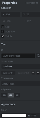

In designer now cant create defines list for use instead constant numbers. Then can be quickly managed all objects.
Now for example i have designs with 150 labels and set some level of white color on every.
After design presented boss say require more darker or lighter texts, then start hard job click on every object and change color, instead we need change one define.
Exist any way to do it now, or is planned in next release ??

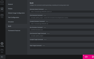

Seems you still missunderstand. We ask add here
one next under Framework Features name it for example master include or defines and place for example one big text area where we write lines required for code. Colors is perfect example, but not only this.
All named constants entered here can be used in any value in designer. For example
#define WHITE #FFFFFF
#define BASEYPOS 27
and swith to canvas
we can fill instead #FFFFFF WHITE and instead location Y BASEYPOS
Result is we have 10 screens 1000 objects and when click Config and change defines value canvas show and use it immediately on all places.
Ofcourse WHITE here is only example , better def name is for example MASTERFGCOLOR etc.
