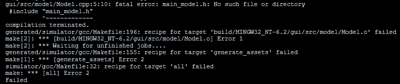

I am new to MCUs in general and now I am working with a riverdi rvt70hssfwca0. My issue atm is that I am trying to run the stimulator on TouchGFX before I can further work on the main issue but it showing the following errors:
while there is no building error when I build it on STM32CudeIDE. I have tried many solutions suggestion I found online but nothing seems to work. Any tips would be appreciated!

The error states that it failed something in Model.o.
Specifically, it mentions
#include "main_model.h"
I don't think there is a file that should be called main_model.
Can you check the beginning of your Model.c file and try to locate where they say #include "main_model.h".
Check if it say #include "Model.h".
If you don't see #include "Model.h", add it manually.

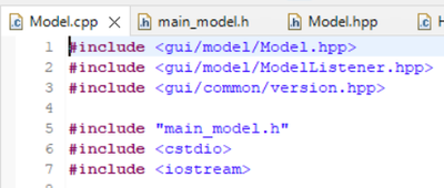

2025-02-20 2:12 AM - edited 2025-02-20 2:41 AM
Hello @GaetanGodart. Thank you for you reply. I am not aware of many details since I didn't start this project myself but from what I am seeing I am assuming the main_model.h was most probably manually added. If i remove it from Model.cpp I get a lot of error since contains a lot of necessary functions. There is a Model.hpp file as well which was included here.
Another thing I have noticed is that the model.o file is missing so is model.c. Is that normal?
