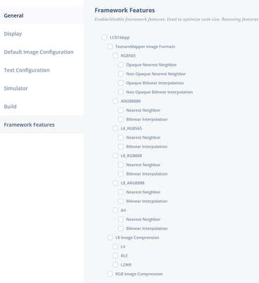

I built it with sucess by: 1st) uncheck "LCD16bpp" into "Framework Features" on "Config" (gear icon) of TouchGFXDesigner software;
2nd) Regenerate the code in TouchGFXDesigner and......finally
3rd) Build Project into stm32CubeIDE..
