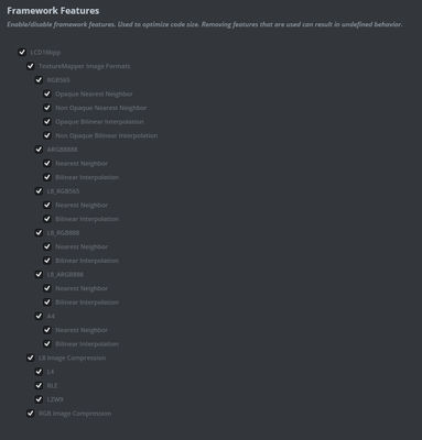

2024-06-12 12:34 AM
Have you checked all the framework features checkboxes in TouchGFX (under Config)? Try checking all of those and regenerating code in TouchGFX.
2024-06-12 3:51 AM
I've checked all of them and the error just continues, i did not touch any framework before so.
