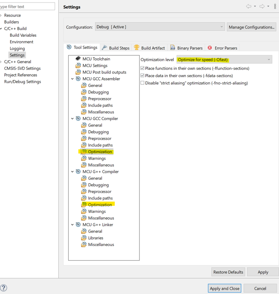

2023-01-18 5:54 AM
Hello Rob H,
We have investigated this bug and we think it's a speed issue. I can suggest you to use the optimize for speed (-Ofast) optimization in your project, that would do the job.
Best regards,
Osman
