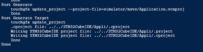

By the way, I would not recommend to link your TouchGFX folder from another project because when you generate code in TouchGFX designer it's pointing to a specific folder (STM3CubeIDE folder) inside your application.
See below the lines when you generate code in TouchGFX Designer :
