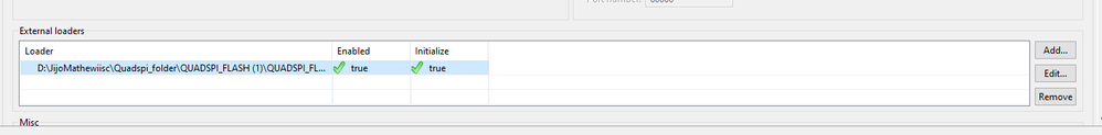

This is my debugger configuration for the Quad SPI external loader. Once I tick Initialize the Quad SPI, and if I debug the code, it gets stuck in HAL delay. is this a Debugger Configuration issue or a Loader file issue? Please help me to overcome this issue

Hello @jijomathew ,
It is a bit hard for me to help you because I do not know why you get stuck in delay.
Can you please provide the call stack?
What do you call the "Loader file" ?
Does the issue happens only when debugging or also on target?
