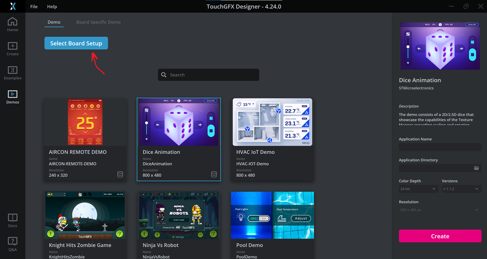

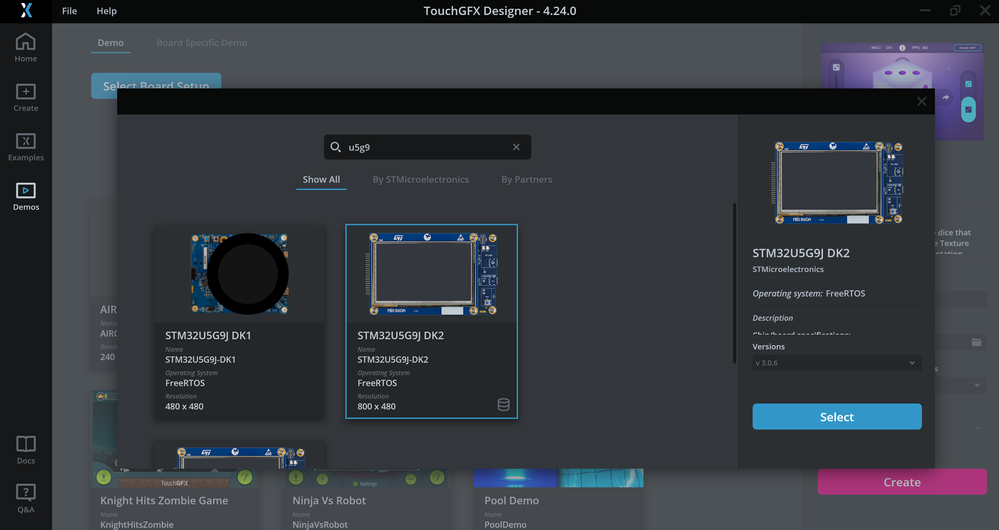

If you want to combine one of the demos or examples with a specific board setup, you can select the GUI first, and then select the TouchGFX Board Setup (TBS) that you want to use.
Selecting the desired demo/example
Selecting the desired TBS

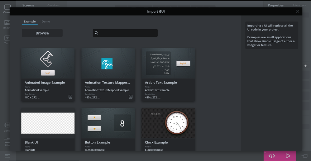

If you are using a custom board, you need to open your TouchGFX project, select Edit -> Import -> GUI and then either select a demo or an example you want, or use Browse to select a custom project
Importing GUI
