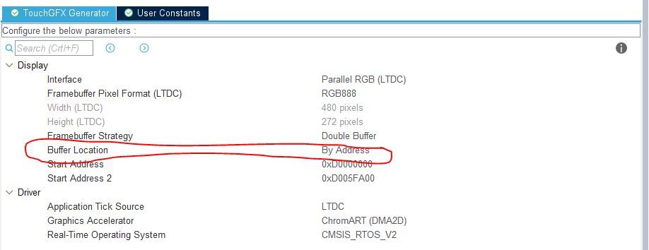

2021-01-20 3:14 PM
Hi Alexandre,
Thank you for your suggestion. We did try it and works...
When compare Touch GFX code to mine we noticed fundamental difference:
in CubeMX -> TouchGFX configuration, see screenshot bellow for the reference
in application generated by touchGFX "buffer location" is selected "By Allocation"
What we are doing: selecting "By address", also address setting what we are using are in screenshot.
we have configure SDRAM following this tutorial:
https://www.youtube.com/watch?v=XnSg3UJfSFc
if (in our code) switch in cubeMX TouchGFX Configuration buffer location to "by allocation" we can see the graph;
but if we use "by address" application crashed.
Please advise,
Thank you,
I
2021-01-20 10:37 PM
Hello IB.1,
The difference between your project and the one generated by TouchGFX is that the Application Template uses the internal RAM for the framebuffers.
Usually
But if I understand correctly you are using the external RAM so by address should be fine. But maybe when you select by Allocation it allocates the framebuffers in Internal RAM which makes it work with a graph. Could you enclose your linker file ?
If by using the external RAM, By address does not work, I suspect your RAM config to be a bit off. Graph is using a canvas buffer that is allocated in the RAM. Maybe there's some conflict but that's just a guess.
