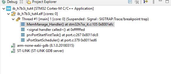

2021-01-17 7:39 PM
Hi Alexandre,
Thank you for your replay. I did try step debug., and crash happen when executing
osKernelStart(); Please see screenshot bellow.
Please advise what else we can try.
Than you,
I
