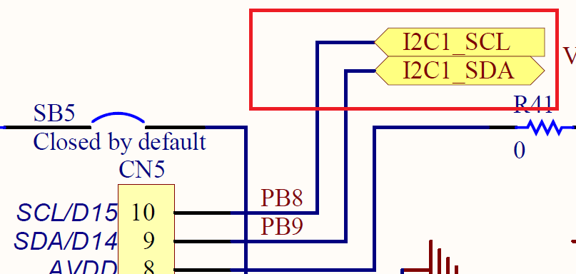

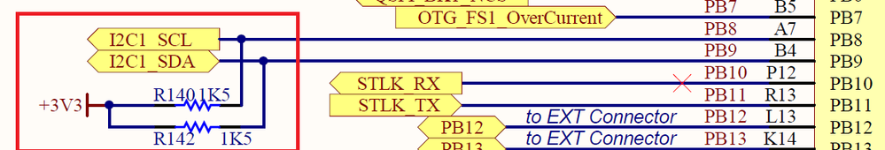

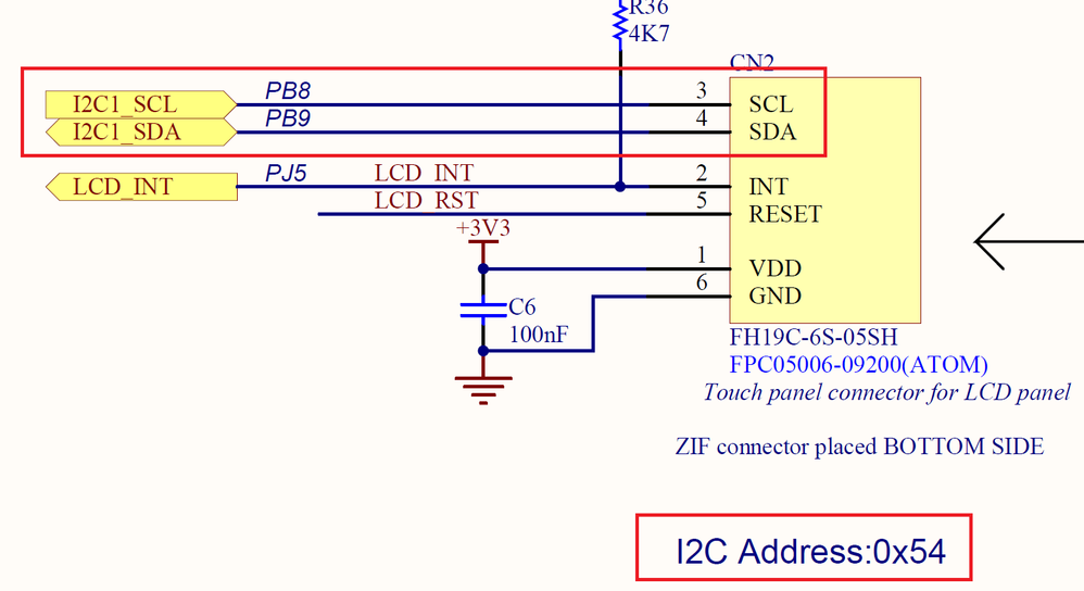

Be careful, if you are using I2C1 (PB8/PB9) for your sensors, LCD touch panel is using the same bus.. Refer to the schematics from this link.
So you need to manage I2C bus addresses .. LCD touch panel I2C address is 0x54 and pull-up resistors are already available on the board.
Arduino connector:
LCD touch panel:
MCU:
