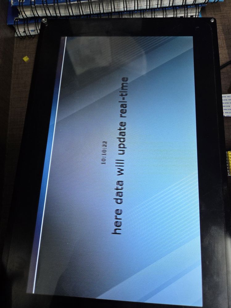

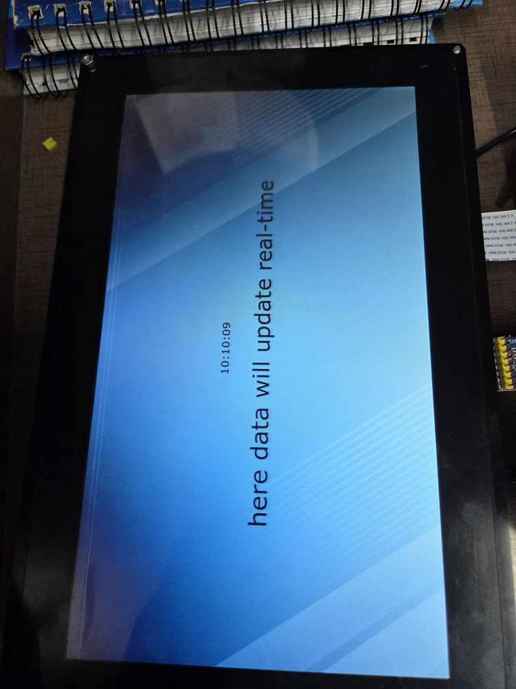

Now i have started working on bigger display with TouchGFX Custom Boards. Im using 10.1 inch 1024x600 touch display. using QUADSPI,SDRAM, FMC and LTDC.
Through TouchGFX Designer i taken one backgoround image, one Text Area buffer and one Digital clock. when im not updating digital clock data and text area im getting proper display.
but when i starts updating digital clock in void screenView::handleTickEvent() then my display starts flickering and white lines appearing on display.

}i dont have a idea whats going wrong with this display. if any one knows please help to resolve this issue.

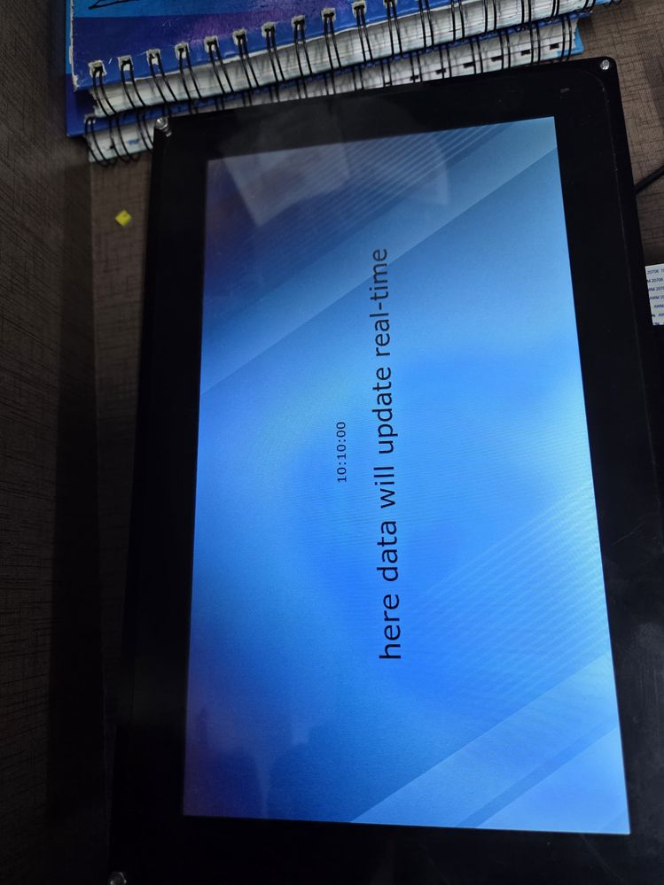

2025-03-12 5:36 AM
Im happy to inform you guys that my issue got resolved!..
There is some issue present in the External crystal Frequency (HSE) , Instead of HSE i taken HSI and its starts working correctly.

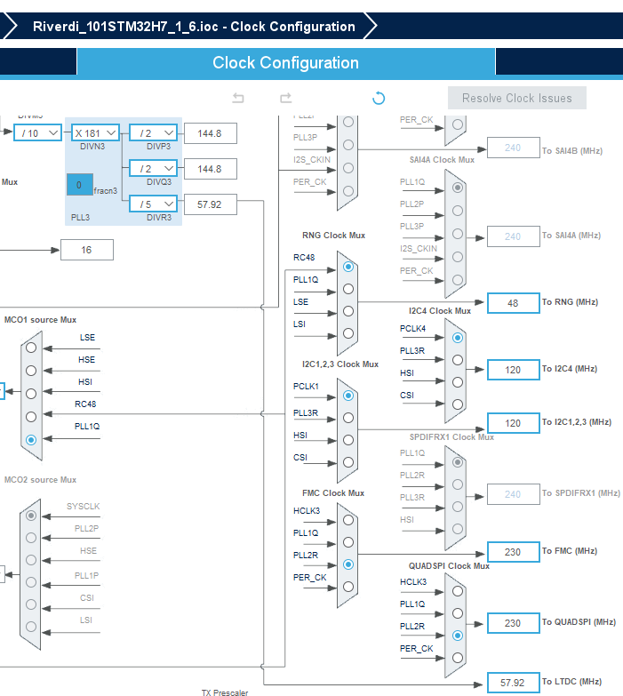

If yours LTDC settings for display are correct, what about LTDC clock ? For 1024x600 you need at least freq around 50-60Mhz - see example bellow - Riverdi 10.1" uses 57.92Mhz

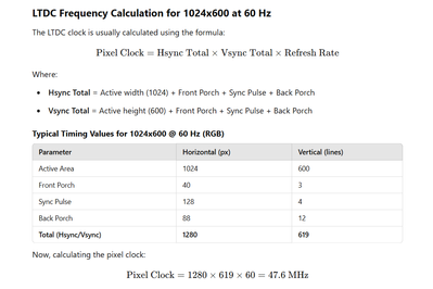

PS: my mistake in first reply: Riverdi 10.1 uses 1280x800 and 58Mhz, so for 1024x600 + some LTDC clock equation

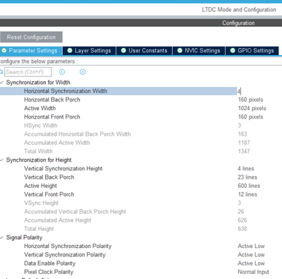

It seems your seetings is correct, anyway try to play with h/v sync width (pdf says h: 1-140 / v:1-20) ) + LTDC clocks between 40 - 70Mhz.

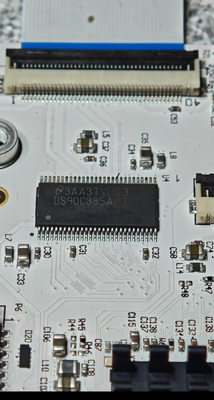

About LVDS circuit: see this picture, t his is LVDS converter made by Riverdi. Differential tracks, equal lenghts of tracks....not easy to design it correctly..... But how to check it....I'don;t know....
