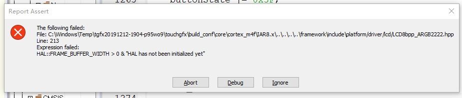

Touch Designer set pix format as ARGB2222, RGB LCD using LTDC setted pix format as L8. In a simple project ,now it can show correctly. But I imgrate this project with a Touch Designer Demo Project , it can not work correctly. Error show

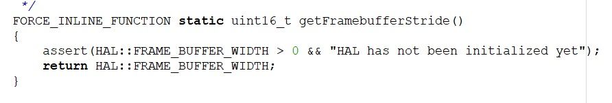

I found
uint16_t stride = lcd().framebufferStride();
Than deeper in LCD8bpp_ARGB2222.hpp
this makes error.How can I fix the error?

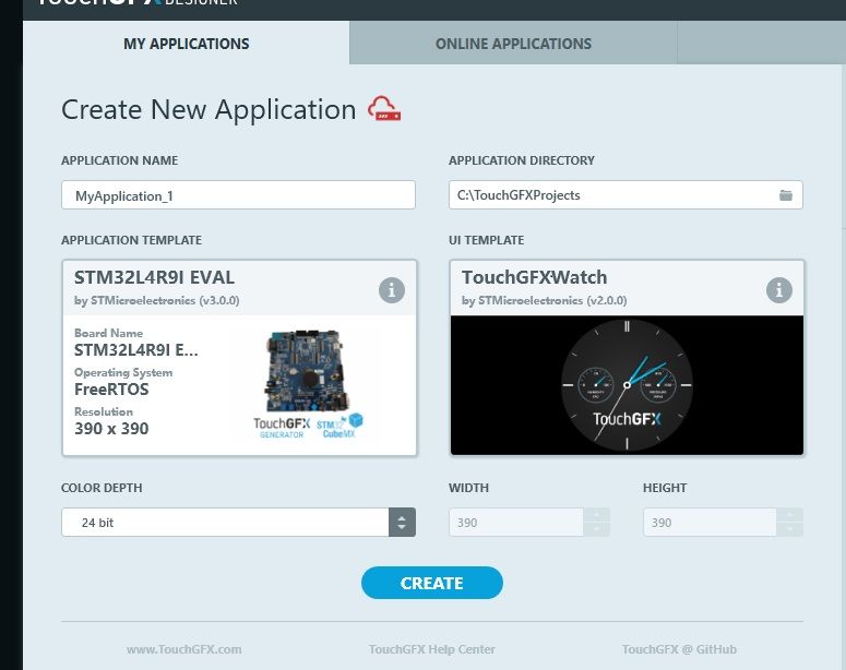

I creata a project using CUBE MX 5.6 and Touch Designer 4.13 , it simpley make LCD and touchgfx work. In this project not using DMA2D, touch desinger not using LTDC, save these setting and code.Most code in TouchGFXGeneratedHAL.cpp, OSWrappers.cpp.Setting in ProjectName.touchgfx, application.config, Application.props,app.mk
Then use Touch Designer make a Demo Project as below.
I like the demo project architecture .
Then I migrate my own project which is only working on TouchGFX simulator, using demo project architecture, using the first project code and setting.
