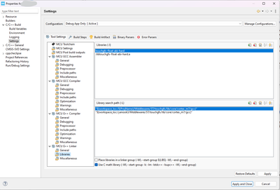

It looks like CubeIDE tries to locate the TouchGFX library and fails. From what you're saying you do have it. Have you tried adding it via "Library search path" in your project properties settings? Below a screen shot:
Regards,
Piotr
