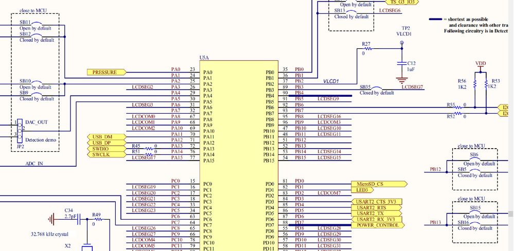

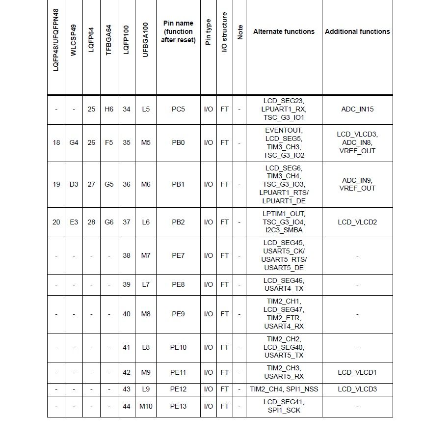

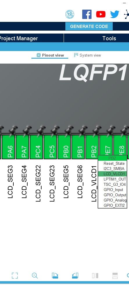

The Additional Function of PB2 is LCD_VLCD2 in the data sheet, but the same pin is set to VLCD1 in dm00171429-evaluation-board-with-stm32l073vz and CubeMX.
Which is correct?
I will attach the corresponding image

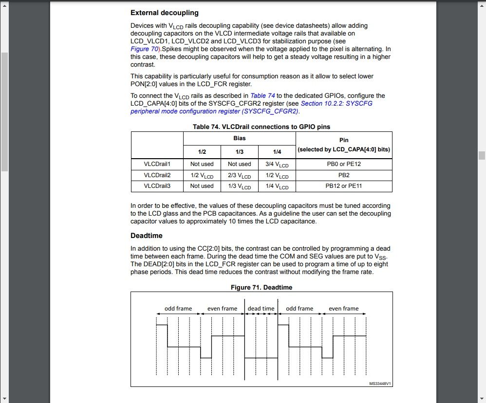

The datasheet is correct.
Regarding the reference manual, table "VLCD rail connections to GPIO pins" is wrong.
The error will be corrected in the next release.

The correct one is LCD_VLCD2.
For documentation, I have reported the error to our team for correction.
For CubeMx,@Khouloud ZEMMELI Could you please fix this typo.

Thank you @Imen GH for doing the check and for taking in charge the follow-up of the documentation issue, I confirm the issue from CubeMX side and it will be fixed.

Well then, Is generated code by CubeMX Wrong?
I want to use LCD Bias Selector with 1/3 Bias.
Please tell me how to fix it. (using the HAL library)

I'm back again to inform you that issue is now fixed, you can use the latest CubeMX version available on site :)
