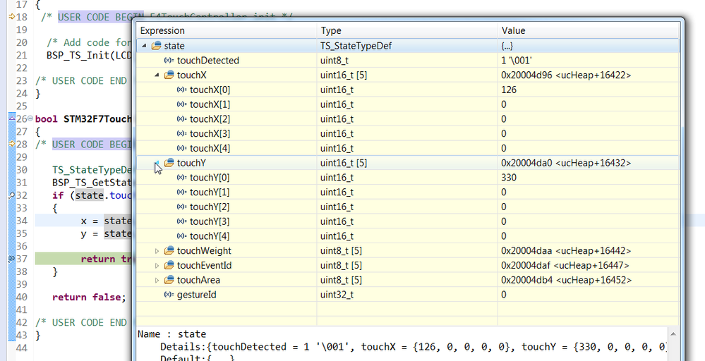

bool STM32F7TouchController::sampleTouch(int32_t& x, int32_t& y) is working as it can be tested by setting a breakpoint. The display is running as it is tested with an animated image that runs fine.

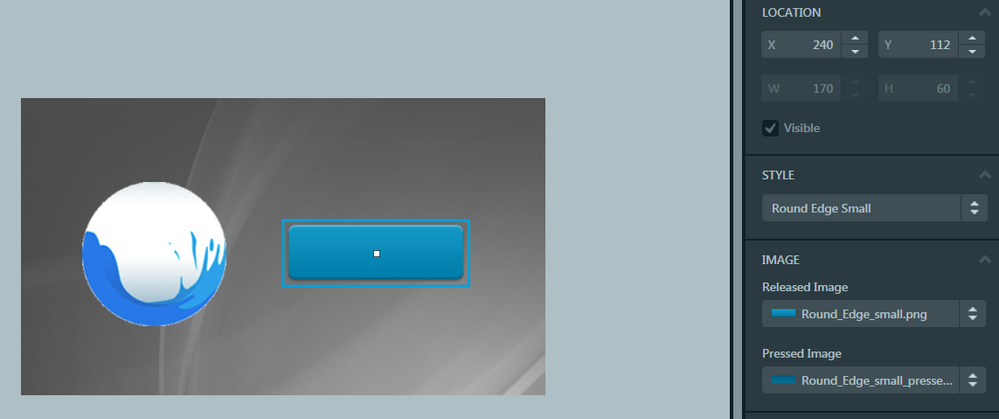

It runs fine in simulator but not on stm32f746G-discovery (Working with STM32CubeIDE 1.1.0) : The display is not reacting on button pressed at all.
Any hints to get the touch working with the display are welcome.
2019-11-06 2:15 AM
So you've tried breaking inside the touch controller and inspecting that the actual coordinates that you're pressing are what's being read back?
/Martin
2019-11-06 2:32 AM
The coordinates seems to be plausible (126, 300).
