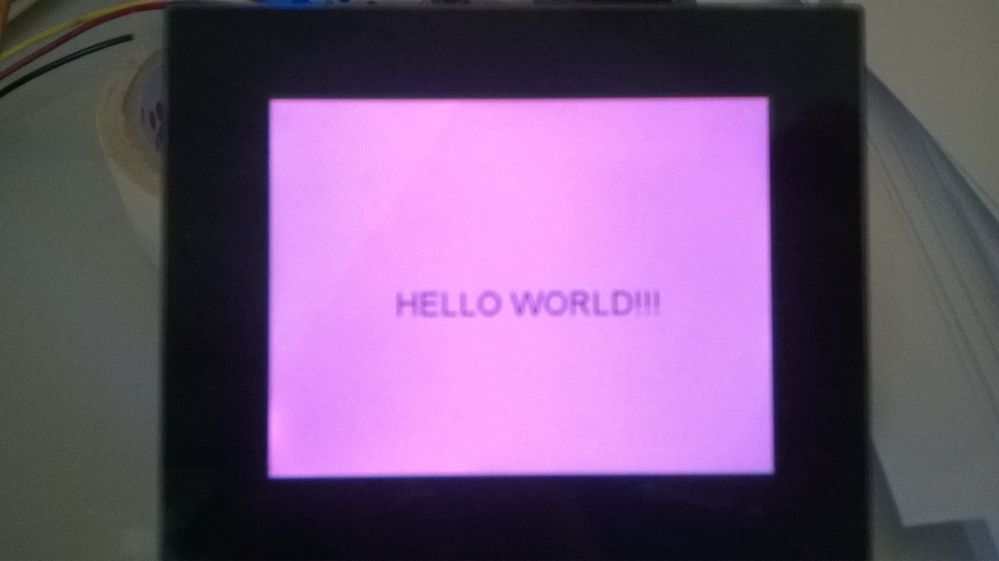

I'm developing a board with STM32F429 configured for a 8080II interface TFT display.
I have a 240x320 TFT (ILI9341) and 5-6-5 frame buffer in internal RAM.
Everything works and actually I flush the buffer on lcd via a loop that write at 0x6C000004 the pixel words (A1 used for register/data selector on Nor bank 4).

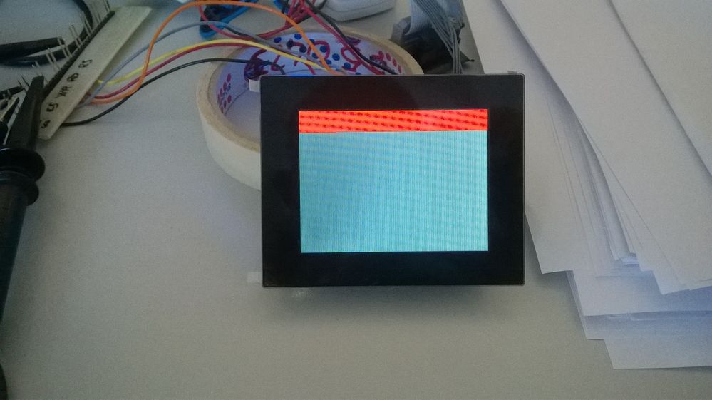

Now, for a better perfomance I would like to use the DMA.
I configured it for memory to memory transaction of 76800 word of frame buffer.
What I got is that only a part of display is refreshed.
The photo with "hello world" is about flushing with a loop, the other is related to flushing with DMA.

2019-10-02 8:07 AM
DMA NDTR is 16-bit so maximum muber of transfers is 65535.
Read the DMA chapter in RM.
2019-10-02 8:07 AM
2019-10-02 8:15 AM
Ooooppsssssss!!!!!!
What a donkey!
Sorry but I really miss that NDTR is 16bit long and not 32!
I think it's time to bed now! :smiling_face_with_smiling_eyes:
Many many thanks for your support.
