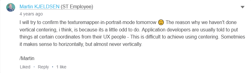

Please do, thank you. Big help. I think it is a common feature (Qt::QLabel, emWin::GUI_SetTextAlign).
However, I found this very interesting comment from Martin KJELDSEN on why it was not implemented:

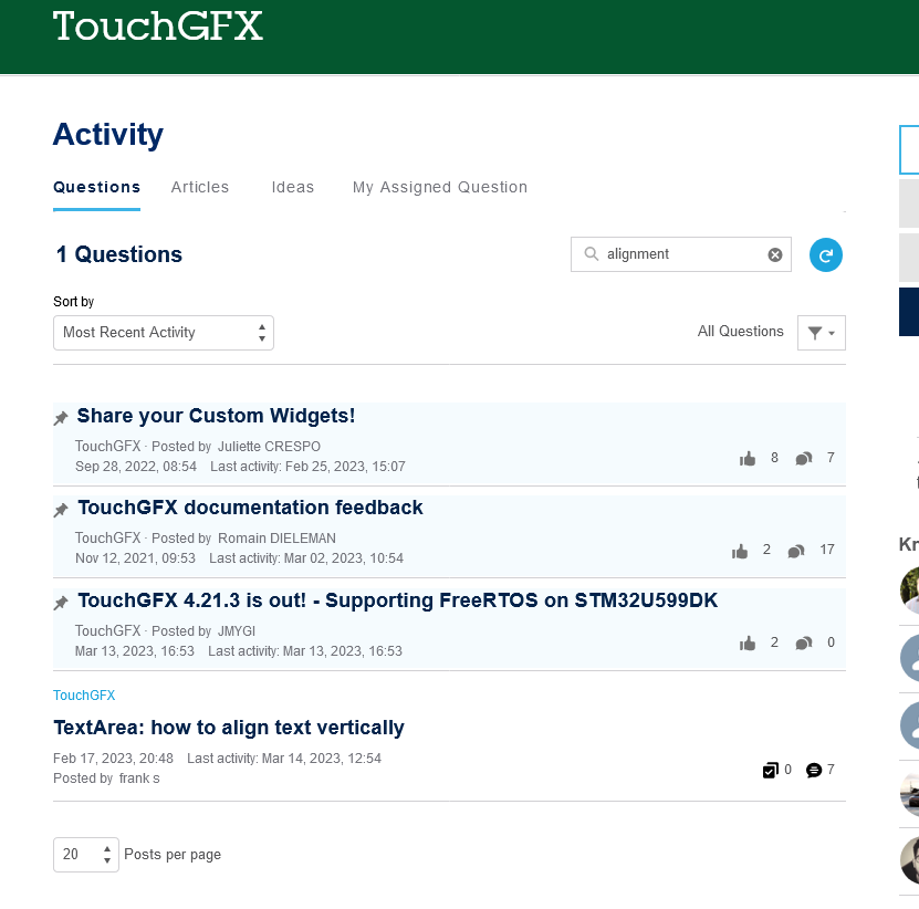

It is unfortunate that they are not listed when searching the forum (with 'align' or 'alignment'):
