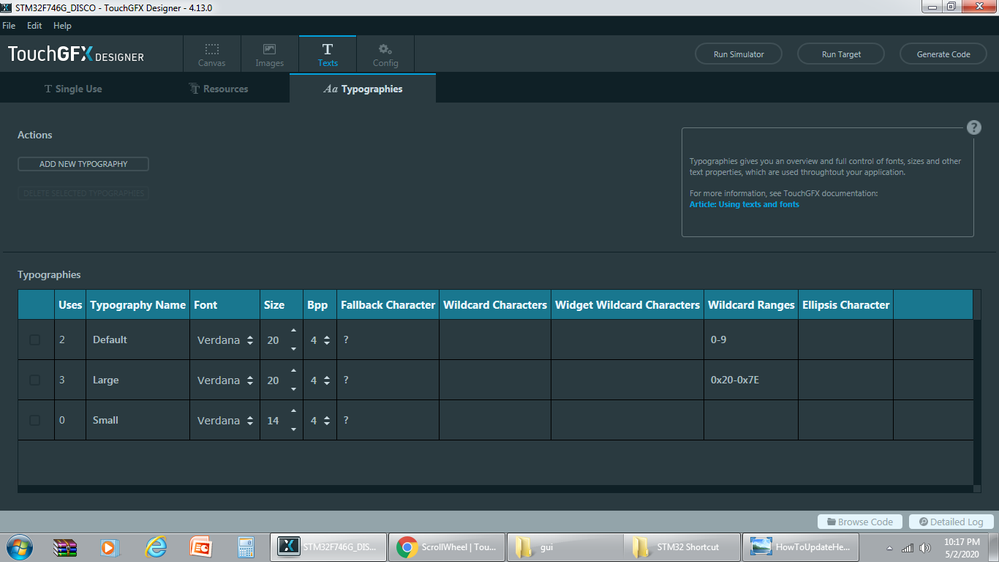

2020-05-02 9:52 AM
Please Check below Image.
