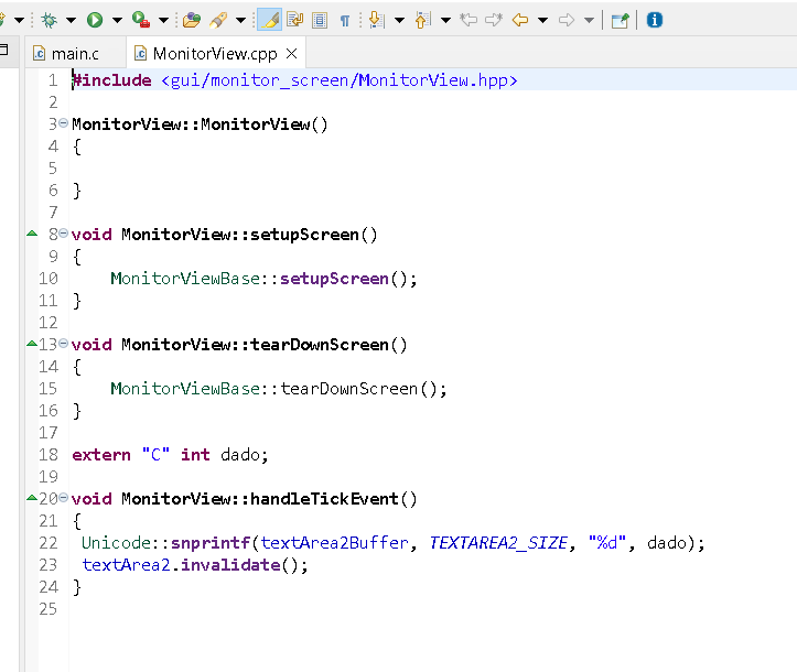

I'm at the beginning of programming in C++, and I'm having difficulty taking a variable from my main.c file to my screen created in touch gfx.
This error appears, where it apparently does not find the variable declaration.
Run Simulator
Generate
Done
Generate Assets
make -f simulator/gcc/Makefile assets -j8
Reading ./application.config
Reading ./target.config
Done
Post Generate
touchgfx update_project --project-file=simulator/msvs/Application.vcxproj
Done
Post Generate Target
.cproject file: ../STM32CubeIDE/.cproject
Writing STM32CubeIDE project file: ../STM32CubeIDE/.project
Writing STM32CubeIDE project file: ../STM32CubeIDE/.cproject
Done
Compile
make -f simulator/gcc/Makefile -j8
Linking build/bin/simulator.exe
build/MINGW32_NT-6.2/gui/src/monitor_screen/MonitorView.o: In function `ZN11MonitorView15handleTickEventEv':
C:\TouchGFXProjects\MyApplication_2\TouchGFX/gui/src/monitor_screen/MonitorView.cpp:22: undefined reference to `dado'
collect2.exe: error: ld returned 1 exit status
generated/simulator/gcc/Makefile:160: recipe for target 'build/bin/simulator.exe' failed
make[2]: *** [build/bin/simulator.exe] Error 1
generated/simulator/gcc/Makefile:155: recipe for target 'generate_assets' failed
make[1]: *** [generate_assets] Error 2
simulator/gcc/Makefile:32: recipe for target 'all' failed
make: *** [all] Error 2
Failed
I followed what the course instructor said, but apparently it doesn't work.

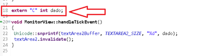

I am not sure the value "dado" is in other .c file (ex : in main.c)
If yes, you can try modify line 18 to "extern int dado;"
