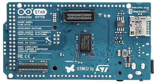

2024-09-05 1:03 PM - edited 2024-09-05 1:10 PM
Yes the panel from the F469 likely a catch-of-the-day from a phone project that may not exist any more.
They connectorized this display for the F769-DISCO and the EVAL board. There was going to be an Arduino board using it too, but that stalled out. STAR OTTO ??
The reason to connectorize is to allow flexibility in implementation, if you own the interface you can rework a daughter card with a display rather than have to reengineer your own PCB with BGA chips every time you have to switch display vendor.
HDMI has a licensing cost, some generic MICTOR connector does not. Still having costs, and be rated for 200+ MHz signalling and clocks..
There are probably a handful of flex-connector options too, but there it's about where the cables exit and fold, and that the panel has been specified by someone moving large volumes, and perhaps less economic to get customized to your own requirements. Or re-engineering at Vendor#2
https://www.elektormagazine.com/news/stmicroelectronics-joins-the-arduino-community
https://community.st.com/t5/stm32-mcus-products/what-happened-to-arduino-star-otto/td-p/475778
