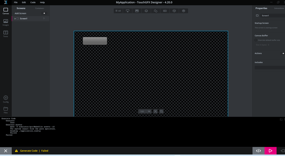

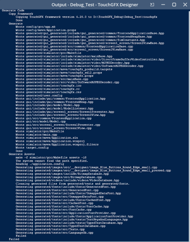

I am facing this issue. always says system can not find specified path. what is this error?

Could you share your log file ? You can find it under %appdata%/Romaing/TouchGFX-4.20.0 for example.

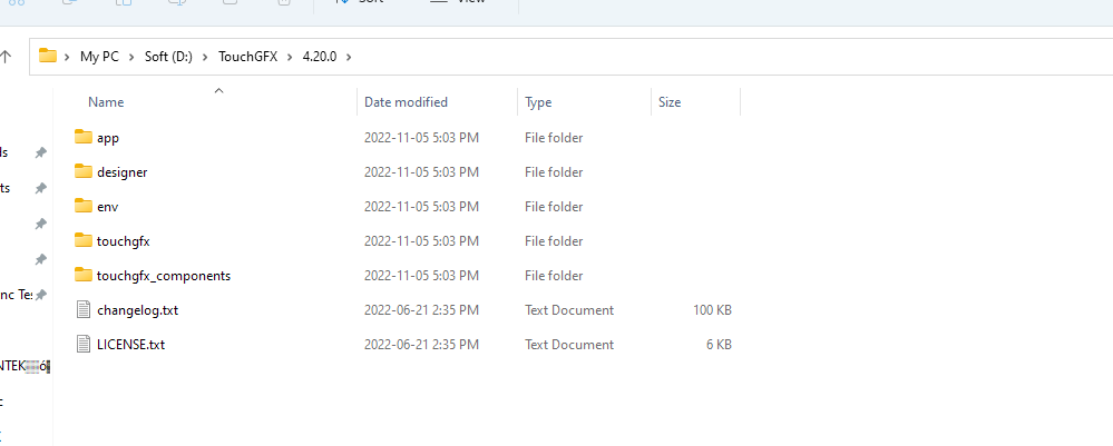

this is my installation path
this is my project path

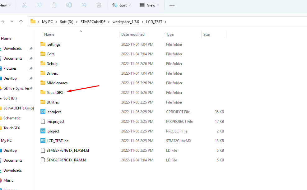

Why is your project put in the workspace folder by the way ? Did you manually set the TouchGFX project generation to this folder ? It would be better to have it elsewhere than in the workspace folder, /D/TouchGFX is fine for example.

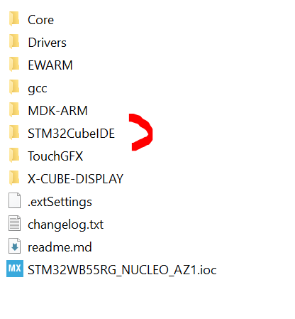

In addition, when you generate a project from TouchGFX Designer with a TouchGFX Board setup for one of ST's development kit, you will see that the project structure is different: the STM32CubeIDE related files and project are under a STM32CubeIDE folder as you can see in the screenshots below. When starting a project from STM32CubeMX we recommend to uncheck the "Generate Under Root" option to keep this project structure, it will ease your development process.

Can you try to create a new project from STM32CubeMX or just start a project from TouchGFX Designer (but in another folder than the STM32CubeIDE workspace) ? I want to check if once again you are missing the .aplication.config file that is generated in your project's /TouchGFX folder.

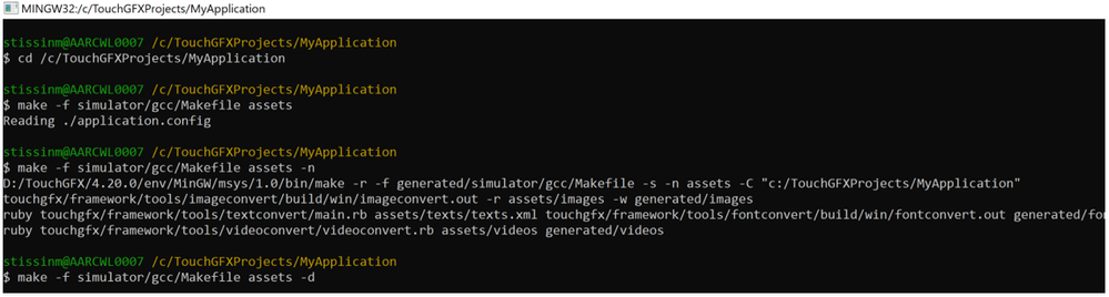

Hello @Shahrear ,
Could you open TouchGFX Environment, change directory to your project root and run make commands, like on this picture :
Please let me know which output to you get.
