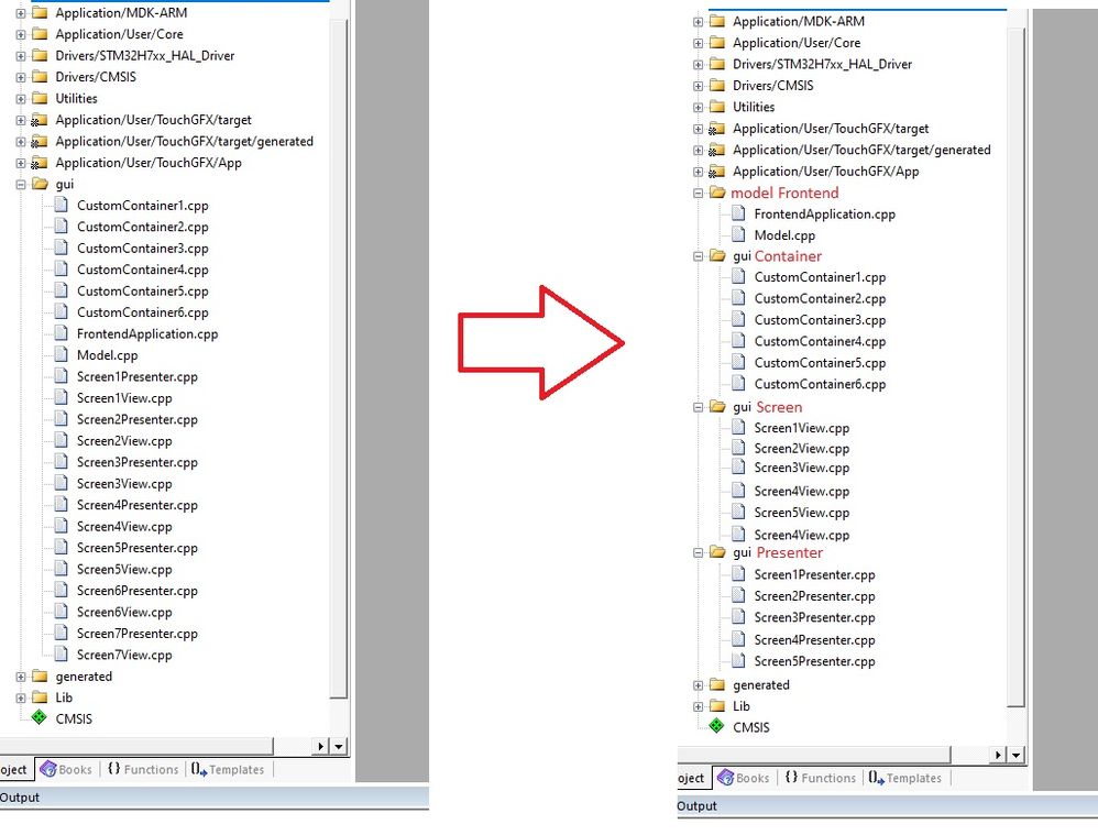

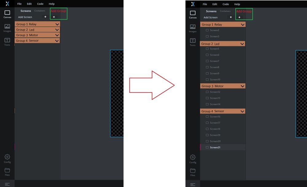

When there are many menus, finding them becomes a bit difficult. If this menu is added, it will be possible to categorize them.

Thank you for this very interesting idea! We've already considered adding a feature to create groups of screens. While I can confirm that this feature is on our roadmap, I cannot provide a specific release version or date at this time.
For the second request, we need to find the best way to categorize the files in general. You suggested separating 'ScreenViews' and 'ScreenPresenters', for instance, but we've heard from other users who want to separate screens instead, like 'Screen1' and 'Screen2'. We are trying to figure out what makes more sense.
