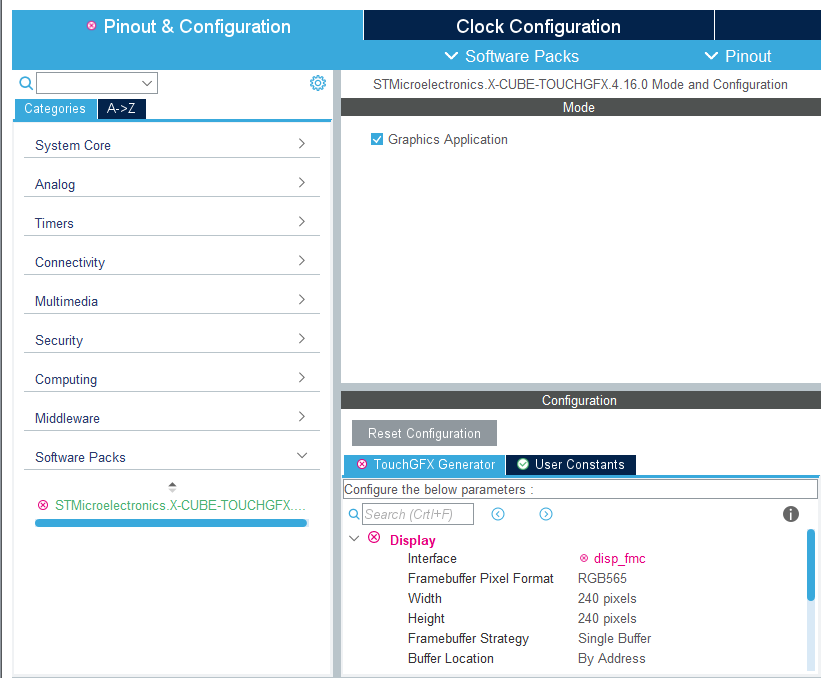

The first problem here is that CubeMX is showing me an Error in the Pinout & Configurations tab under Software Packs -> STM X-Cube TouchGFX (i'm using version 4.16.0, since 4.16.1 doesn't seem to be supported by TouchGFX Designer) -> TouchGFX Generator -> Display -> Interface is set to disp_fmc and marked with a pink 'X' (see image below) the only other Option i can choose for this is Custom, which will lead to the same compiling errors in CubeIDE.

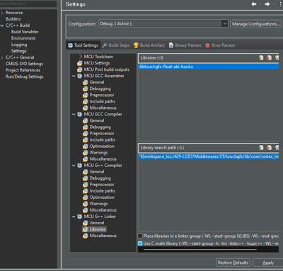

Error :
C:/ST/STM32CubeIDE_1.13.2/STM32CubeIDE/plugins/com.st.stm32cube.ide.mcu.externaltools.gnu-tools-for-stm32.11.3.rel1.win32_1.1.1.202309131626/tools/bin/../lib/gcc/arm-none-eabi/11.3.1/../../../../arm-none-eabi/bin/ld.exe: cannot find -l:libtouchgfx-float-abi-hard.a: No such file or directory
collect2.exe: error: ld returned 1 exit status
"make -j8 all" terminated with exit code 2. Build might be incomplete.
I also check the setting patch but I don't know what I have to do there
