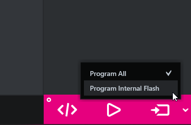

You can flash only the code (not the assets) when building and flash through TouchGFX Designer :
Would that be enough for you to flash through TouchGFX Designer?
Regards,

OK, sounds good!
