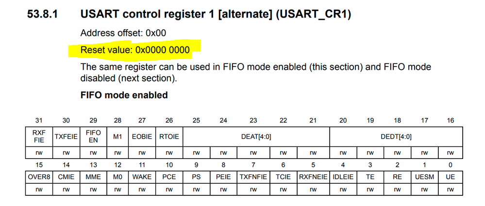

The reference manual I was using is RM045, and I don't see the reset register values... for example, Section 53.8.1 on page 2004 details USART_CR1 (FIFO-enabled), but I don't see the reset values there... am I looking in the right place? I remember also looking in that general section and not finding it.
That being said, that page looks very useful and has the settings I was curious about. One question though - will there be issues if I use PB10 and PB11 so it uses the onboard STLINK-V3E through CN26, instead of the listed PB14 and PB15 which are routed through CN6 and require an external STLINK device?

> RM045
You mean RM0455?
It's at the start of each register. "Reset value"
