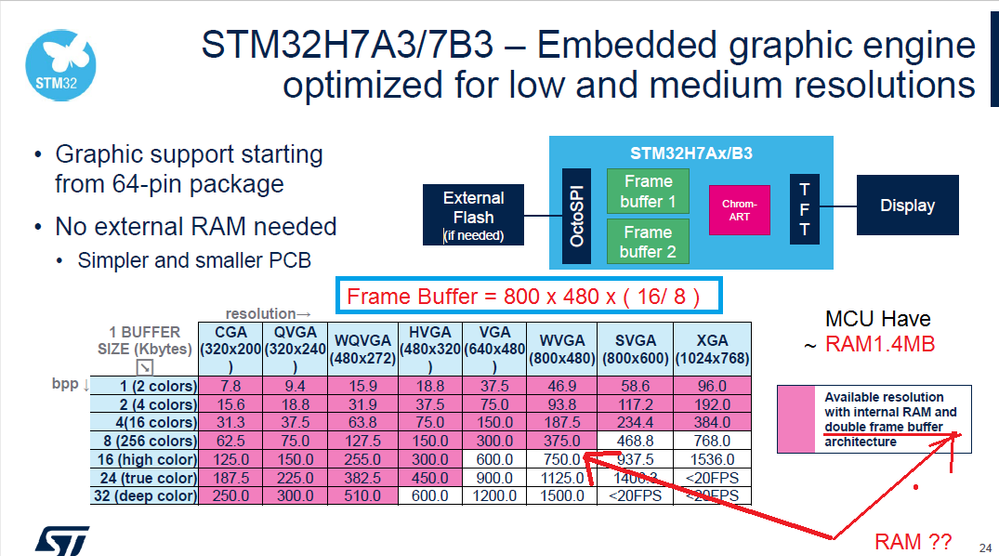

Few days back , I have attended webinar "Explore Graphics, Artificial Intelligence, and Voice UI Applications with the STM32H7A3/B3" .
How 1.4MB RAM is segregated ?
Can you please help me understand below image ?
Why only 510 Frame Buffer in used for Frame Buffer ?

2020-05-20 2:03 AM
Hi, i'm confused by your arrow and your comment on 510 Kb ram. But, if we do the math for the 510 case (480x272, 32 bpp)
( 480 x 272 x 4 ) / 1024 = 510 KB - You could fit two of those in internal RAM with memory left to spare

@Martin KJELDSEN (ST Employee)
Frame Buffer = 800 x 480 x ( 16/ 8 ) = 750
But , Why I can't access 750 KB RAM (From Internal RAM) as per slide image of 1.4 MB RAM ?
