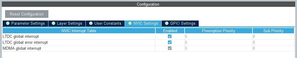

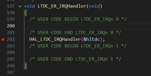

2023-07-31 4:31 AM
Yes, if your project is in CubeMX, you can enable the LTDC global error interrupt by going to Multimedia -> LTDC -> NVIC Settings. After generating the code, set a breakpoint on the function "LTDC_ER_IRQHandler" in the stm32h7xx_it.c file.
Here are the screenshots of the process:
Enabling LTDC Interrupt in CubeMX
Setting the breakpoint
If the issue is an underrun, the breakpoint will be triggered with these settings. You can then check the LTDC registers or call stack to identify the source of the problem.
