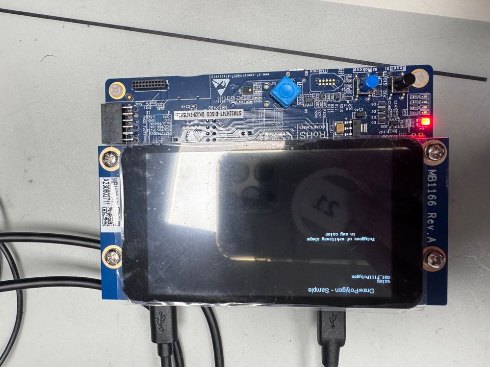

Board STM32H747i-DISCO
ID - STM32CubeIDE 1.14.0
Samples from STM32Cube_FW_H7_V1.11.1
stm32h747i_discovery_conf.h in common folder modified with
/* LCD controllers defines */
#define USE_LCD_CTRL_OTM8009A 0U
#define USE_LCD_CTRL_NT35510 1U
#define USE_LCD_CTRL_ADV7533 0U
Compiled build and send to board, but dont work.
some text are visible in the LCD but look like after the first prints, the
next text or draws are not send to the buffer, or buffer is not send to the display or.....
Here is the display from the example HelloWorld using the 2DGL_DrawPolygon.c from
http://www.segger.com/emwin-samples.html
the Maintask call to :DrawPolygons() and this is the source
static void _DrawPolygons(void) {
int y;
y = 90;
// clear display
GUI_SetBkColor(GUI_BLACK);
GUI_Clear();
// display text
GUI_SetColor(GUI_WHITE);
GUI_SetFont(&GUI_Font24_ASCII);
GUI_SetTextAlign(GUI_TA_HCENTER);
GUI_DispStringAt("DrawPolygon - Sample", 160, 5);
GUI_SetFont(&GUI_Font8x16);
GUI_DispStringAt("using", 5, 40);
GUI_DispStringAt("GUI_FillPolygon", 5, 55);
GUI_DispStringAt("Polygons of arbitrary shape\nin any color", 160, y + 90);
//GUI_Delay(500);
// draw filled polygons
while (1) {
GUI_ClearRect(100, y, 220, y + 85);
GUI_SetColor(GUI_BLUE);
GUI_FillPolygon (&_aPointArrow[0], 7, 160, y + 80);
GUI_Delay(1000);
GUI_SetColor(GUI_RED);
GUI_FillPolygon (&_aPointStar[0], 8, 160, y + 45);
GUI_Delay(1000);
GUI_SetColor(GUI_GREEN);
GUI_FillPolygon(&_aPointHexagon[0], 6, 160, y + 45);
GUI_DispStringAt("Polygons of arbitrary shape\nin any color", 16, y + 90);
GUI_Delay(1000);
And as you can see in the picture, only few text are in the LCD but not the Polygon,
If you remove the first Delay, you can see some polygon. but not more.
I am doing something bad? I forgot something in the configuration for the examples?
Thanks
2023-12-26 2:38 AM
Hello @ManuelOV,
GUI_Init must be called before any STemWin function is used.
Note that before initializing the GUI, the CRC module (in RCC peripheral clock enable register) should be enabled.
More details can be found in the chapter "4 How to use STemWin Library step by step" in the AN4323 Application note.
2023-12-26 2:46 AM
Absolutely, both are sett and call before, Tak ein mind, what is not working is the example, I have only include the STemWin file, but if you use the standar helloword, and add a loop to write other text in different places will notice dont work
In main.c
line 135 and forward
/* Init the STemWin GUI Library */
BSP_SDRAM_Init(0); /* Initializes the SDRAM device */
__HAL_RCC_CRC_CLK_ENABLE(); /* Enable the CRC Module */
GUI_Init();
GUI_SetFont(&GUI_Font32_ASCII);
GUI_DispStringAt("Starting...", 0, 0);
/* Initialize LCD and LEDs */
GUI_DispStringAt("Initializing lcd...", 0, 32);
/* Activate the use of memory device feature */
WM_SetCreateFlags(WM_CF_MEMDEV);
MainTask();
Main task call to the STemWin loop
2024-01-02 10:54 PM
Maybe dot was clear in my response, I did it previously, so your reply is not helpful
Please if you are part of ST please check the samples in the board, and will notice most of them dont work.
If you are employee of ST and dont have access to this board with this display, please ask to the people in charge of the board and let him the software must be fixed.
THANKS

2024-01-04 10:59 AM
I have compiled (build) the example with my modification to check if the double buffer work, and not yet, even with your news files in my local repository, do not work, I must do something bad.
Any how, would you be as kind to test in your computer if the project work?
in the 747i-disco choose the LCD_DSICmdMode_DoubleBuffer_CM7 and inside look for the main.c file
As you already now, this file show alternatively two images. copying the image to the front buffer.
To check if the library work with the double buffer I use the UTIL_LCD_DisplayStringAt(X,Y, (uint8_t *)"Prueba",RIGHT_MODE); to write "Prueba" in the display, and no matter with buffer will be in this moment the assocated with the back_buffer must be used for the UTIL library, and the text must be displayed in the next frame, or viceversa, just as I has not read the whole source code.
Instead write Prueba every time in the display, only print the text one time yes and the next no, and you can see the flick.
Please replace the original main loop for this one in the main file, and please download it in the board, and let me know if in you system the text "prueba" flik or is printed all the times?
