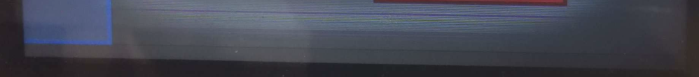

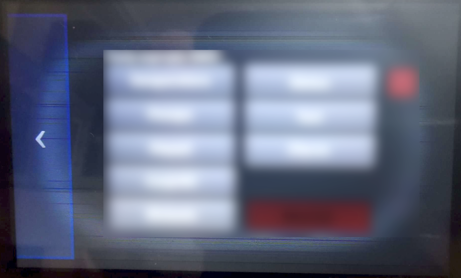

0693W00000QNu7wQAD.pngNotice the light ring around the screen content, also the horizontal lines - they are not there normally.
0693W00000QNu9YQAT.pngHere's the larger version of the bottom of the screen.
The picture was taken a few minutes after it happened. Earlier it looked far worse, the ring was solid white, the original content was barely visible, the whole screen blinked.
I don't know how to even reproduce it. I don't know if it would be even safe to reproduce it.
