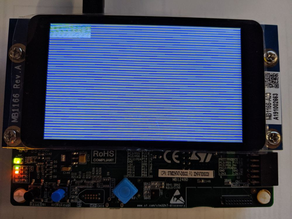

I am really new to the STM32 und TouchGFX World. So I bought a board STM32H747I-DISCO, the first thing I saw: not supported in STM32CubeIDE :(
I generated a new Project with TouchGFX, I selected the Application Template (16 Bit) with a Blank UI. I placed a Button With Labelk in the left upper corner:
- Generate Code: "Code generation complete"
- Run Target: "An error occured during flash. Please make sure you have the right target connected."
I used the STM32 ST-LINK Utility and downloaded the File "...\My Application\TouchGFX\build\bin\initflash.hex" - the result can be considered in the appendix :(

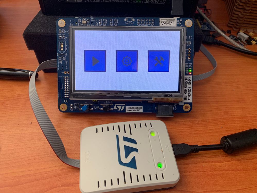

Hi, welcome to STM32. Dual core processors are not yet implemented in STM32CubeIDE. It will come but nobody knows when. I have got a STM32745i-Disco board and I have successfully downloaded a test screen from TochGFX designer. To develop code for both cores you have to use System Worbench (see picture TouchGFX CM7, CM4 blinking led) .
For the STM32H747 I have created a TouchGFX designer project (attached). Try downloading the target.elf file. Building code from command line 'TouchGFX 4.10.0 Environment'. Change folder to TouchGFX and run 'make -f ../gcc/Makefile -j8' and 'make -f ../gcc/Makefile -j8 clean'.

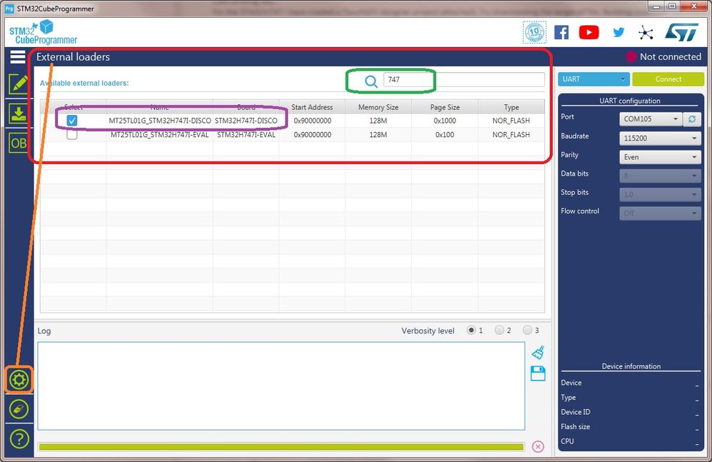

try flashing the file called target.hex, it also contains the graphical assets, these are stored in the external QUADSPI flash on the board.
When you flash "intflash.hex" only the the application code is flash to the board.
Also, for STM32H7 MCUs please use STM32CubeProgrammer for flashing since it will continue to support the H7 line.

You have an External Loader selected for the onboard QSPI?

Ok, I am able to download the files. Do I always have to download the two files target.hex and intflash.hex? And with which tools can I programm the STM32 can I use STM32CubeIDE?
2019-07-25 2:24 PM
One file is the executable code which goes into Internal Flash memory, and one is the imagery data which goes into the External Flash memory.
