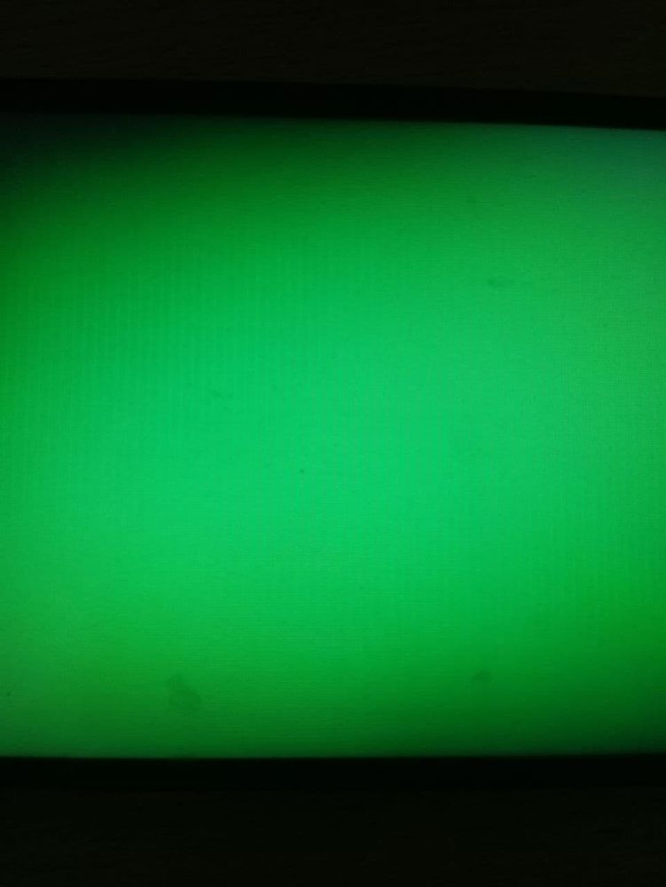

Hello, frackers. I'm trying to bring up a DSI display with ILI9806E controller and using the same hardware blocks LTDC + DSI. Board is based on stm32h747 with 32MB SDRAM 16-bit width. LCD_DSI_VideoMode_SingleBuffer from STM32H747I-DISCO was taken as a start point. I have changed the initialization sequence according to found open source examples. LTDC and DSI timings were set too. I have checked that ILI9806E controller's registers were written and read properly. The display refuses to work properly. There are some strange stripes after filling the screen with a color... Also there is an inexplicable behavior in dynamics, while changing one color to another.. Have you succeeded to run up your display??

I (eventually) received panel initialisation details from the LCD manufacturer. They were quite a lot different to what I'd started with from online trawling and after that everything just worked (apart from a couple of tweaks to the PCB layout on the DSI lines to improve stability).
So, I'd recommend talking to your LCD panel manufacturer as the init details will vary from one to the next.
