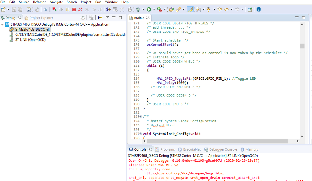

and this immage
you can see that i don't run the resume, if I comment the scheduler
// osKernelStart();
I always have the same problem, don't run the program
