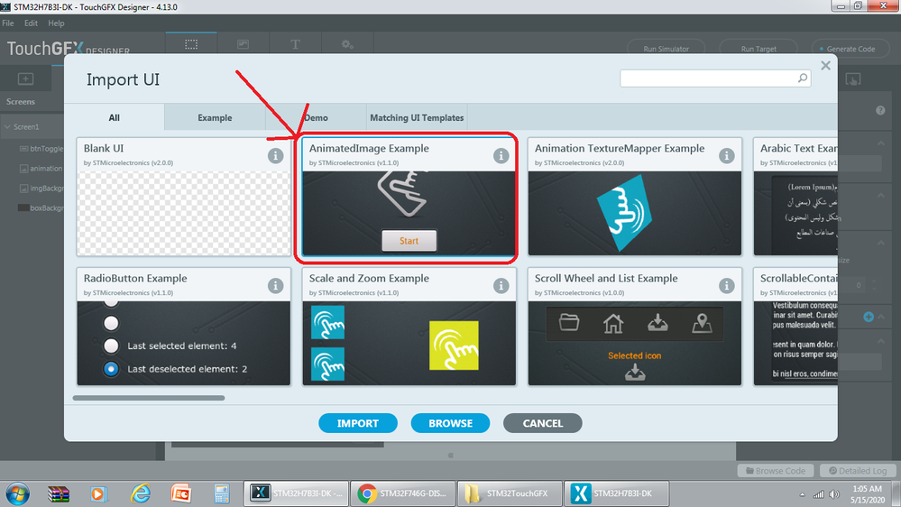

2020-05-15 7:02 AM
2020-05-15 10:18 AM
Are you doing changes in ScreenWorkViewBase.cpp ?
Please visualize your problem .
Karan
