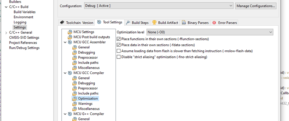

Have you got a chance to play with compilation optimization capabilities ?. Maybe your final binary sized may be shrunk a bit helping you to fit your current hardware resources. Let's play with project settings and C/C++ build settings if STM32CubeIDE.
2020-02-17 1:03 AM
hi thanks for your answer, i have default optimization, Optimization Level -O0 , as you can see for immage that i attach
