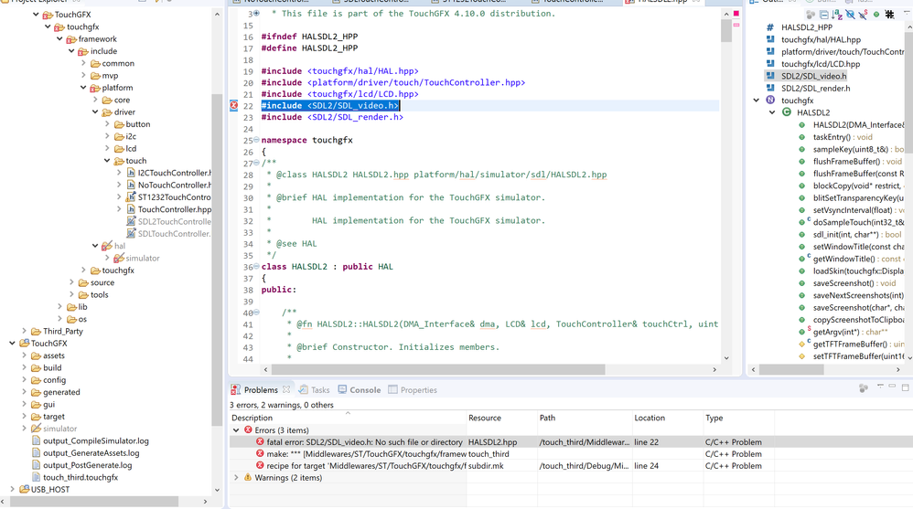

However, I am still facing the following error :
Regardless to the fact that i excluded all simulator related files and folder, I still getting :
"Description Resource Path Location Type
fatal error: SDL2/SDL_video.h: No such file or directory HALSDL2.hpp /touch_third/Middlewares/ST/TouchGFX/touchgfx/framework/include/platform/hal/simulator/sdl2 line 22 C/C++ Problem
would really appreciate any guidance.

Hi @Ash,
It's difficult to follow the compilation error from the screenshot, but there must be something trying to include SDL2. Maybe do a project wide search for which .cpp files do that and exclude them from build.

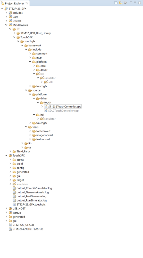

Hi @Martin KJELDSEN , Thanks a lot for your response,
I could manage to compile the project by excluding folders as following :
Also, could upload the code and see the image on the display.
