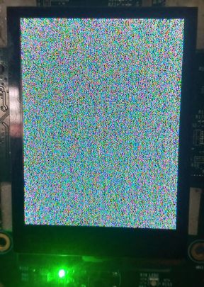

I sent a write data to LCD like display the RED background on the LCD panel. But it display like this-
this is my code part:

Can anyone help me?

It is hard to help you, I don't know what ST7789H2_WritePixel does. You should double check that this function works.

Hello @Meenakshi ,
It seems the function you are calling to write to your screen is "LCD_Fill(0xF800, 0, 0, 240, 240);" which does this :
for (uint16_t i=0; i<height; i++)
ST7789H2_DrawHLine(RGBCode, Xpos, Ypos++, width);
I do not know what ST7789H2_DrawHLine(RGBCode, Xpos, Ypos++, width); does.
Also, this function above is not related to TouchGFX but to (I assume) the library you are using.
The second code you share (I don't know the name of the file) is not related to this function I think.
For TouchGFX, it is recommended to test the LCD control by following this guide if you put your framebuffer in internal ram and this guide if you put your framebuffer in external ram.
Furthermore, you want to do a TBD (TouchGFX Board Setup), so you should follow the board bring up guide .

2024-10-15 12:47 AM
Hi @GaetanGodart ,
I changed my code. Still I got the same output.
void LCD_FillScreen(uint16_t color)
uint16_t x, y;
for (y = 0; y < LCD_HEIGHT; y++) // Loop through the height of the screen
for (x = 0; x < LCD_WIDTH; x++) // Loop through the width of the screen
ST7789H2_WritePixel(x, y, color); // Draw a pixel with the specified color
void DisplayRedBackground(void)
LCD_IO_Init(); // Initialize the LCD (if not already initialized)
LCD_FillScreen(RED); // Fill the screen with the red color

2024-10-15 10:46 PM
Hi @GaetanGodart ,
I'm not using TouchGFX because it is difficult for me. I can't write a code to my custom board. So, I try this way to access my LCD (FSMC + ST7789H2). But, still, I'm not getting an output. Can you please provide any example code for accessing the LCD display?

Hello @Meenakshi ,
In that case, it would be better to watch some youtube video guide:
- https://www.youtube.com/watch?v=QURw04sQ--Y
- https://www.youtube.com/watch?v=RWujOLXBFrc
It is hard for me to help you there because it will be specific to the display and board you chose.
These video guides will show you how to use a standard display with an STM32 but keep in mind that you should use the proper library that is necessary to control your own display as well as assigning the right pins, delays, etc.
