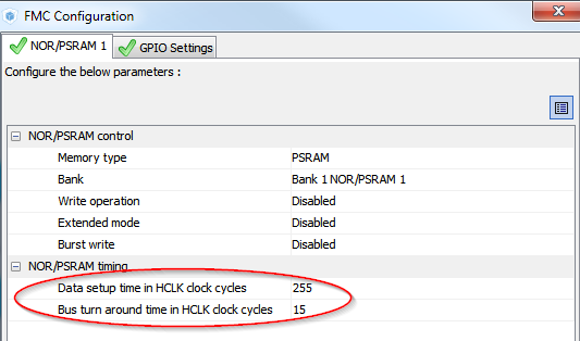

In your first code, I think the culprit were, that you used FSMC_ExtendedMode_Disable ,although you gave FSMC_AccessMode_D.I think you need to enable extended mode, if you plan to use anything besides AccessModeA.Have a look at the datasheet regarding this part.In your newer code, it seems to be corrected, and you do mention an 8x improvement, so thats good.But I think you forgot to set thetiming.FSMC_BusTurnAroundDuration
See that you give it some reasonable value.As a matter of fact, the stm32cubemx comes in handy to check, what exactly youl should care about while initializing a peripheral.

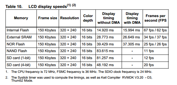

1. Now I am able to get 12.5 FPS on 800x480, this describe one is able to achieve 62 FPS on 320x240 resolution. So for this TFT resolution I will get ~25FPS just half what they achieving. What may be the reason? thing that I figure out is distance of wire between TFT and discovery board? my wire bus is about 25cm.2. I am doing communication in 16bit 565 color mode. When I put image on TFT, colors are different than actual I am using BmpCvt from segger. How come I over come this issue?2014-06-25 3:35 AM
12.5 seems in line for a display with x5 the number of pixels.
2014-06-25 1:23 PM
I checked that link, and that's for a STM32F1 series running on 72MHz, whereas the FSMC clocked at 36MHz.
