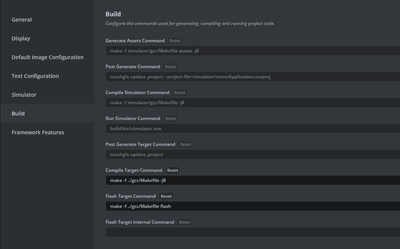

Hello @miker ,
1- To be able to run on target, you have to write your own Makefile, and configure your touchgfx project to exexute compilation target command :
You should try to get inspiration from our existing TBS to know what to put in your Makefile (in the gcc folder).
