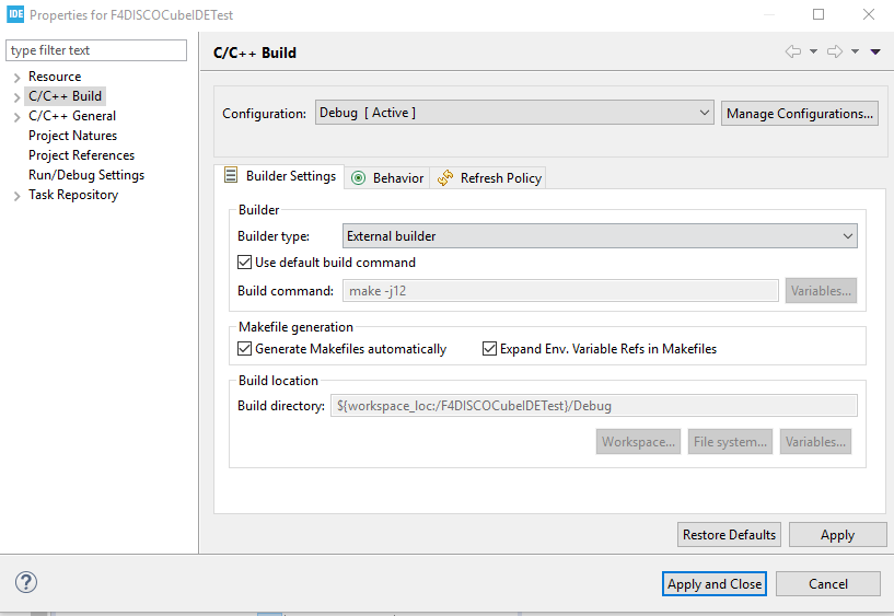

Right click on the project select 'Properties' and click 'c/c++ build'

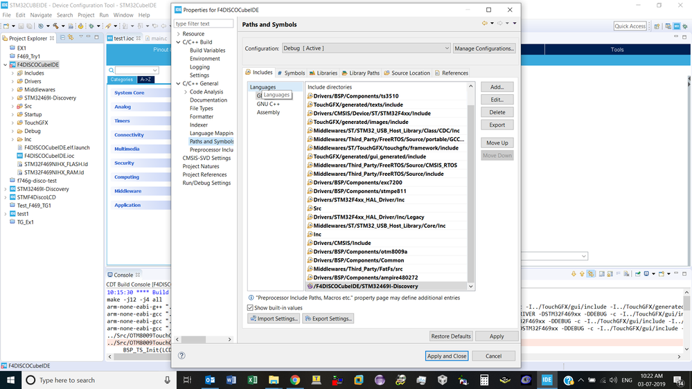

2019-07-02 9:54 PM
MIne CUBE IDE Version 1.0.1 is it make difference ?
My Path Variable

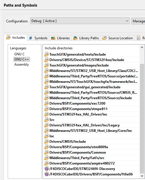

@senthil Does you cpp paths look like this?

I've upgraded to version 1.0.1 projects builds with out error.

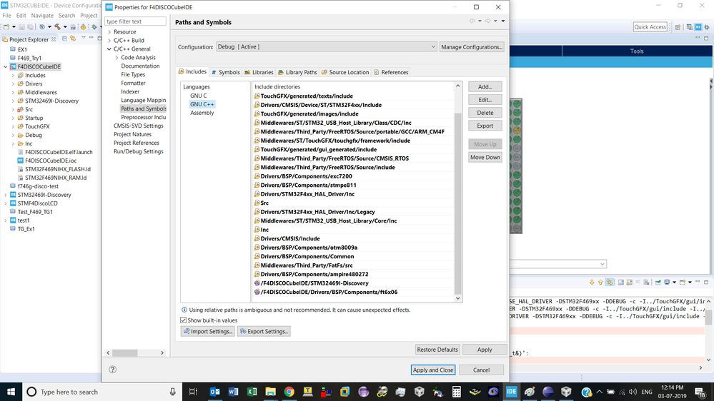

2019-07-02 11:45 PM
My GNU C++ Paths
2019-07-02 11:48 PM
@senthil Ok, if you right click on 'BSP_TS_GetState' and select 'Open Declaration' does the ide take you to the declaration?
