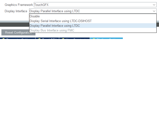

However I don't know which pin to select for the LCD reset and which protocol option to use:
Can anyone please advice?

hi the 32F469IDISCOVERY use serial dsi host lcd
and i think the reset pin is j15
(the parallel options is usually for rgb screens )

2019-06-10 12:33 AM
sorry I got confused between the 32F469IDISCOVERY to 32F769IDISCOVERY in the f7 its j15.
and it seems that pin is PB0 because all the others are audio,leds,etc ..
good luck
2019-06-10 3:07 AM
Following the help so far I have set the display connection protocol to serial and assigned PB0 as the reset pin. I have been able to compile and build an image. I have loaded the image on the board using STM-LINK all good so far. When the debugger takes over the four LEDS light but the display is blank. Now I've placed a break point in the TouchGfx code on the Screen1ViewBase::Screen1ViewBase() constructor but the breakpoint is not being triggered.

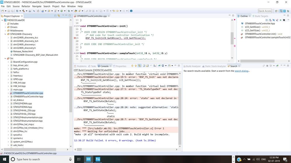

I got Error How can i resolve it
../Src/OTM8009TouchController.cpp: In member function 'virtual void OTM8009TouchController::init()':
../Src/OTM8009TouchController.cpp:19:5: error: 'BSP_TS_Init' was not declared in this scope
BSP_TS_Init(LCD_GetXSize(), LCD_GetYSize());
../Src/OTM8009TouchController.cpp: In member function 'virtual bool OTM8009TouchController::sampleTouch(int32_t&, int32_t&)':
../Src/OTM8009TouchController.cpp:27:5: error: 'TS_StateTypeDef' was not declared in this scope
TS_StateTypeDef state;
../Src/OTM8009TouchController.cpp:28:24: error: 'state' was not declared in this scope
BSP_TS_GetState(&state);
../Src/OTM8009TouchController.cpp:28:24: note: suggested alternative: 'static'
static
../Src/OTM8009TouchController.cpp:28:7: error: 'BSP_TS_GetState' was not declared in this scope
make: *** [Src/subdir.mk:91: Src/OTM8009TouchController.o] Error 1
make: *** Waiting for unfinished jobs....
"make -j4 all" terminated with exit code 2. Build might be incomplete.
11:30:54 Build Failed. 6 errors, 1 warnings. (took 4s.613ms)

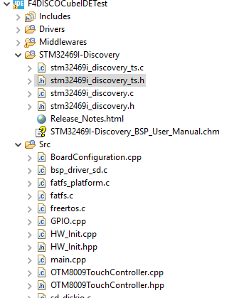

2019-07-01 11:55 PM
Couple of things to check first does your project contain the following source items.
Secondly I noticed your make command was 'make -j4 all' I'm using 'make -j12 all' also what version of make are you using?
2019-07-02 12:09 AM
I am Using
STM32CubeIDE
Version: 1.0.1
Build: 3139_20190612-1256 (UTC)
The Make is build in . How can i change that one.
My Files
